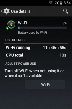

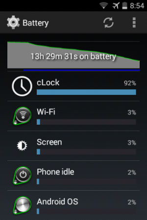

This looks really positive to me.
This is even with "Keep WiFi on during sleep" set to "Always."
Now it's the cLock getting mad about me having the location turned off overnight that's draining the battery.
For me it's usually the screen.
