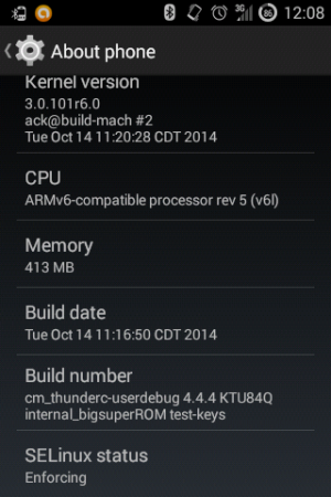

mount -o rw,seclabel,nosuid,nodev,relatime,remount /dev/block/mtdblock6 /system
mount -o rw,seclabel,relatime,remount -t rootfs rootfs /
I think the catch was the "seclabel" part. Something with the new kernel or add-ons or something wouldn't let it mount without that. Also, even with everything else the same, busybox still takes issue with it. I don't even understand what "seclabel" does (something to do with selinux, maybe? NEWB!), but busybox must not like it. Either way, it works so I'll be posting a new version of my script for the last internal shortly.

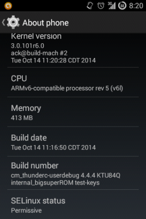

probably built that release with selinux enforcing turned on in kernel. when I was paying attention, it was built permissive selinux mode instead.
is odd, in twrp with enforcing kernel I could only get ext2 partitions mounted with busybox (forgot to activate security settings on ext2 in kernel config.)
