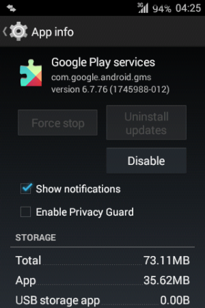

syguyice, I can confirm that reverting Google Play Store to "factory" version fixes the pop-up problem. I was unable to revert Google Play Services. The button is greyed out although Google Play Services is listed under downloaded apps (see screenshot). Does that mean 6.7.76(1745988-012) is my stock version, or does that mean Google Play Services is somehow preventing me from reverting it? In either case, the pop-ups went away with only Google Play Store reverted. Later, Google Play Store self-updated on mobile data although I enabled "update on Wi-Fi only." I'd rather not disable it because I like auto updates for my other apps. Is it safe to try something like this (can't post link yet, search for "trick how to disable google play store t2951378" on xda) on os2sd?

You have no clock lag and a working video camera? What doesn't work on your build? :eek:Screenshot_2015-03-14-04-25-28.png

Thanks, that link was ingenious and a great trick; I'm gonna try it when I get home. For uninstalling updates, I imagine some of your apps (and/or system components) are using features from the newer googleplay services, thus OS prevented you from uninstalling. I wish I could offer something as clever as the post you found, although the only thing I could think of is a (dangerous) suggestion to rename your android gms.apk file under /data/app and restart. Be sure to have a nand backup ready before the rename just in case the phone fails to boot. For your reference, my current googleplay services is 5.0.89, and no longer exists under the "Downloaded" section.

Update on Google Play Store and Google Play Services autoupdating nasties: I applied the trick on Google Play Store by adding the "com.android.vending-1.apk" folder a few days ago. It worked and took care of the problem (multiple-at-a-time pop-ups). Google Play Services updated itself to 7.0.97(1791429-012) today, and I got single-at-a-time pop-ups. As bigsupersquid suggested, I was able to extend the trick to Google Play Services by adding a "com.google.android.gms-1.apk" folder. I am now back to 6.1.88(1557022-012), and pop-ups free. :) By the way, I had to apply the trick in airplane mode because the autoupdating nasties reinstalled themselves immediately after I uninstalled them.

Tracking these updates, backtracked and added the gms-1 folder to the app/data.
Didn't actually roll back play store, just services. We'll see if it keeps working. Did install and update with play store, so it doesn't mind using the original services with a newer store.
