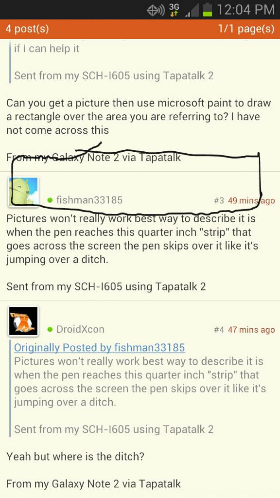

Pictures won't really work best way to describe it is when the pen reaches this quarter inch "strip" that goes across the screen the pen skips over it like it's jumping over a ditch.

Yeah but where is the ditch?

The area inside the square
