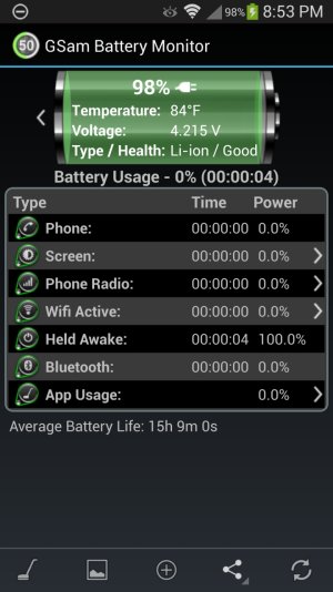

Using one of the battery monitoring apps? No. What am I looking for?
skipatrol: I do have total equipment protection on the device from Sprint. You are correct though -- there is a 1 year warranty. Problem is, I risk getting a refurbished unit if I have Sprint replace it.
Here is a perfect example. I took the OEM battery that was fully charged on a Anker wall charger and popped it into the phone. When I turned on the phone it was at 100%. I plugged the OEM charger in and started playing around with the phone just for a few minutes (looked at pictures, texted, etc) and it dropped by 1% and continues to drop as I type this message.
