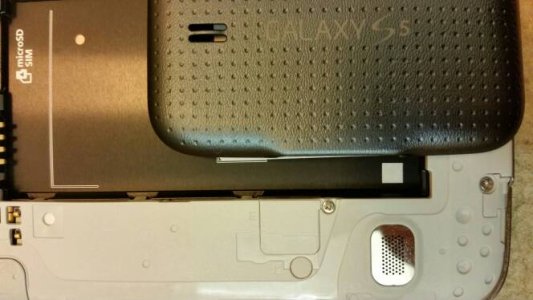

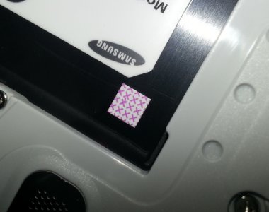

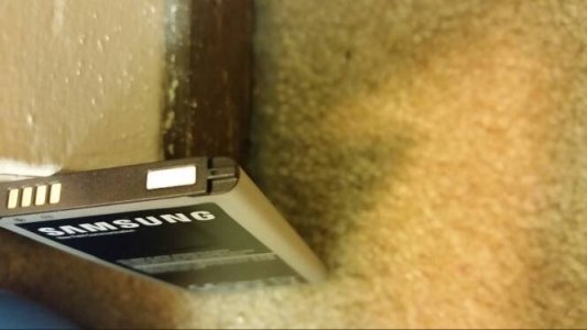

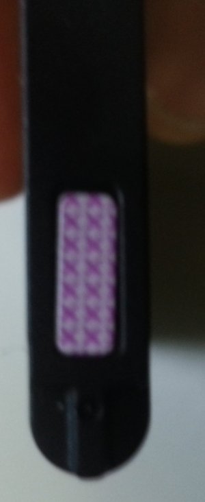

My S5 arrived yesterday and both the battery and the phone itself have purple Xs on the water ingress sticker (images of both attached). That means that it is NOT "water damaged", correct? I read somewhere that it IS damaged if there are Xs, but somewhere else that the Xs mean it has NOT been touched by water, as the purple Xs 'bleed' out into the sticker and turn it red if water touches it.
This is the second S5 BestBuy.com has sent me, both with purple Xs on the stickers. Just making sure it is all good before I let them off the hook.
Thanks in advance for any assistance you are able to provide!20140821_161937.jpg20140821_161714.jpg

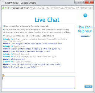

Went straight to Samsung for help. Appears that the sticker would have been all pink/red if damaged, not white with Xs. See attachment.
If someone with a VERIZON S5 could confirm, that would be awesome!

And I think it needs to be clarified--based on what I read on various web sources, I think a water damaged sticker will be solidly pink or purple, depending on the initial color of the X's. That rep made it sound like the purple X's would change to pink X's, which I don't think is the case. In the OP's situation, the sticker would turn all purple if water damaged.
I think that was what the OP was getting at when he asked "All pink, correct?"
