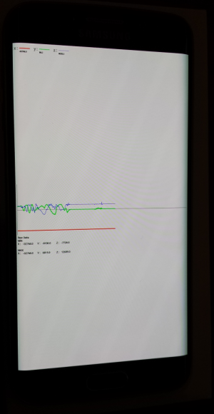

Someone made me aware of the sensor debugging stuff, so here is a graph that shows the x angle sensor is ****ed:
Ugh. Stupid. My account has less than 10 posts so I can't post a link.
it's at imgur: sL33Wfb

I'm having the same issue plus my camera shows everything up side down. Is there still no solution to this? I would hate to return my Edge to get another with the same problem.

did the *#0*# to test the sensor
Accelerometer Sensor x is stuck at -32768
someone on the xda forum said theirs was stuck at the same. hopefully there is a software fix for this.
Your sensors are most likely ok. I used that app too.. try an app called CHECK MY ANDROID. It actually references sensors and not the bugged framework variable. UPDATE: Redacted... the variable was messed up, I just didn't scroll down far enough in the other app to see it!!! ***
