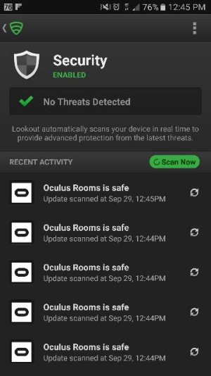

It's the stupid "Oculus Rooms" app. That crap installed automatically last night, and now it keeps endlessly installing itself. I can't delete it because it always keeps coming back. Look at Lookout:

Same problem started this morning. After reading above, I un-installed Oculus Home first, then the rest of the Oculus suite including Rooms. Seems to have stopped the constant scan of Oculus Rooms. Phone is charging now, so we'll see what happens. Another interesting thing that started this morning. About every 15 minutes, my phone would sound some kind of alarm. Still haven't figured out what it was, but it stopped after I took it off the charger.

Same. The only way to fix the problem was to uninstall everything Oculus related. At least my phone is no longer overheating and losing charge.

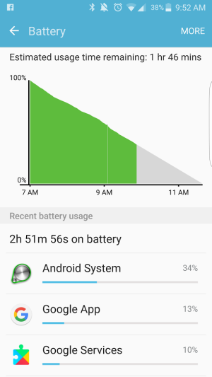

I've been having the same issue. Here is the graph of my battery drain: Screenshot_20160929-095230.png
The only difference I noticed was the Oculus Rooms as well. If I uninstalled everything Oculus how can I get it back after everything is fixed?
