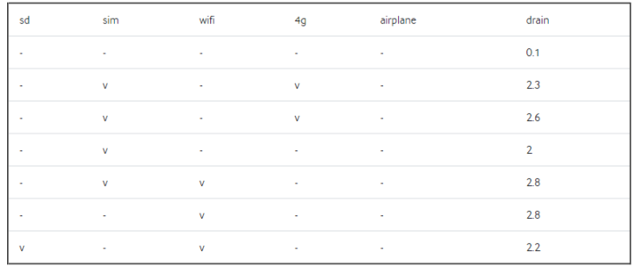

Example of the tests I ran:
sd sim wifi 4g airplane drain
- - - - - 0.1
- v - v - 2.3
- v - v - 2.6
- v - - - 2
- v v - - 2.8
- - v - - 2.8
v - v - - 2.2
My last test was to pull out both SIM and SD cards, WiFi off, AOD off. High accuracy for location. Not in safe mode. Not in airplane mode. Overnight it drains at 0.1% per hour. I concluded the phone is physically free of defects.

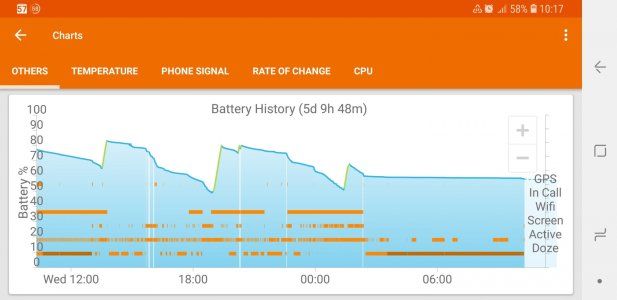

Please notice the screenshot of GSAM chart. What is that active signal that keeps going on in the background? The only way to stop it is to pull both cards and disable WiFi, and the drain rate downed to 0.1% per hour.
- - - - - 0.1
- v - v - 2.3
- v - v - 2.6
- v - - - 2
- v v - - 2.8
- - v - - 2.8
v - v - - 2.2
