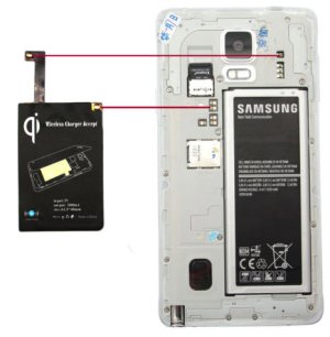

bertsirkin
Oct 17, 2013
547
16
Visit site
You can always purchase a wireless charging transmitter pad and receiver from eBay - they're relatively cheap and don't affect the phone size in any way. I paid about $17 for the pad and receiver and it works great. It uses the same protocol that the official Samsung back does, so charging is no different. The receiver fits between the standard phone back and the battery - it's paper-thin. You can still charge with the USB port with the quick charger or with any standard charger.
Wireless charging is definitely slower than with most USB charging scenarios, but, if you charge overnight, it really doesn't make much difference.
Here are some links: http://www.ebay.com/sch/i.html?_odkw=note+4+wireless+charging&_from=R40&_osacat=0&_from=R40&_trksid=p2045573.m570.l1313.TR1.TRC0.A0.H0.X%22note+4%22+wireless+charging&_nkw=%22note+4%22+wireless+charging&_sacat=0

If you get the little recharging module I would think most cases would still fit on. I kind of modified my Note 2 case so it was flat. Haven't got my Note 4 charging module but it is stated to be Thickness: 0.6mm(minimum)-1.5mm(maximum)..

Keep in mind many of those pads will block or affect NFC. For my old S4, I used them without issue but had to find the right one. For the N4, I just went with the S-View Wireless Charging Back.
