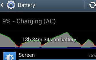

eta: Beats me if this will help or not. Here is a ss of the battery life this morning.
