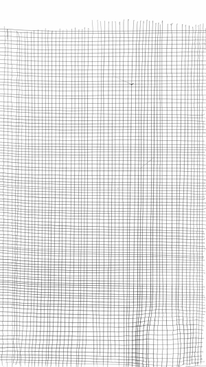

Hi everyone
just bought a new Note 4. I was so excited, started to draw and... noticed a screen problem. On the lower right side on the screen, my drawing was a little bit off. Not much, about 2 mm, but of course nobody want to see that on new device. So I took a ruler and made grid. Attached file shows what happens. It made a sphere, so something pushes pointer out of center point. Not the speaker, cause its a bit in different place. Must say, that pointer acts weird on the corners also - bounces, get off screen, back on it etc, while s-pen is stable.
I don't have Samsung's or other's magnetic case, actually I don't have any.
Does anyone has the same problem? Is there any chance to fix it without getting a new Note or taking in to service point?
Looking forward for your help and opinions
Konrad
wow, clever diagnostics!!!
I tried the same on mine and nope, I don't see that 'bubble'. Are you using any smart case with magnets or something like that?
It does seem to coincide with the speaker position (which has a magnet, of course). But yeah, if this is not cause by a case, I'd start the warranty exchange process...

They're goona replace mine, but don't have any on stock at this moment. It was 910C with Exynos. Actually I bought one on last thursday, had to change it cause it was shutting down every 5 minutes. One I described with the picture and pen problem was the second. Both 910C. I dropped by to other store and 910X which is demo model was working just fine. Left point exactly at the spot i drew it on.

No, I don't have any case. I actually wait for new one, my 3rd in a week, but store doesn't have any on stock right now. I hope it finally would be a perfect one. Cheers!
1) It's a manufacturing tolerance defect in the screen manufacture (or the screen calibration, if there is any - I don't know the specifics down to that level), it has nothing to do with the chipset, Exynos or Qualcom.
2) Since the S-Pen doesn't work by electromagnetism, a magnet shouldn't have any effect. (Edit - I just tried moving the "pen cursor" with a strong magnet - it does has enough of an effect to cause about that much distortion. Strange, it shouldn't. Any physicists here familiar enough with electric field work to comment?)
Might be some of the coils in the 'sensing' layer Synycalwon quotes that got shifted. Either by a magnet at some point, a manufacturing defect, or a phone drop strong enough to dislodge that portion of the sensor. Either way, it's a hardware issue and should either be replaced or repaired.

Hello all. I had the same issue with my note 4 but had 2 dead spots on the right of the screen and also the pen wouldn't activate apps if the icon was in the dead spot. The phone was in a flip type case with a maget on the back. When I removed the phone from the case the dead spots disappear.
