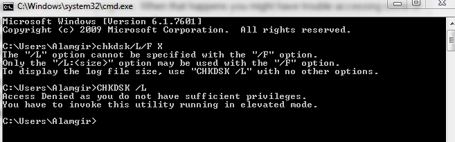

I tried using CHKDSK /x /f <Drive Letter>
but CMD replies:
--->Cannot open volume for direct access.

i just got the same thing try this - first open the command prompt by putting cmd in the search bar from the start key. then open the command prompt and click on "run as administrator" then run the prompts
