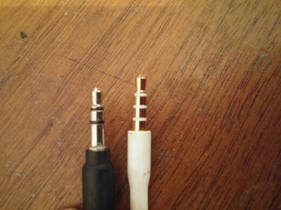

I think I've figured something out. I also use the auxiliary port to listen to music in my car and have random drops but I don't have them on my rear buds. While looking at the actual plugs, I noticed that the car cable has colored 2 rings on the Jack and the ear buds have 3. So I plug in some other speakers that I have that has 2 rings and surely plug it into the auxiliary port on the phone. I can see the audio notifications change on the phone. I did the exact same thing with my ear buds and nothing happened. I am thinking that 2 colored ring cords are what is causing the problems. Is a theory.
Here is a pic of the auxiliary cords.

I'd noticed this too -assumed the 3rd ring was for the microphone (as I only have earphones with mic's on them) so hadn't mentioned it. Presume this is where the issue stems from though.
