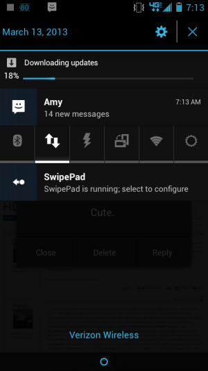

I tried downloading and after 8 hours nothing downloaded-_-, then I turned the phone off and back on, then i got the wifi error so i turned wifi on and off then went back to system update and it began to proceed, finally glad to get This update! :D -Razr Maxx
Re: Update won't download (I'm on 4.0.4) (Edit: SOLVED)
It appears that Motorola has solved this issue. :)
Sent from my Samsung Galaxy Note II
