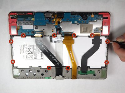

Beut Well-known member Apr 29, 2015 511 1 0 Sep 17, 2016 #4 In this picture, the touchscreen flex cable is at the center. When fully inserted, the line on the cable should be aligned with the one on mainboard, otherwise it's not seated properly. In the picture, it's already disconnected
