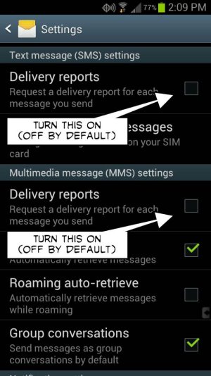

Are you using the stock Messaging app? Are the failed notifications occurring with SMS or MMS or both? Is there a particular contact that this happens with? If so, is that contact an iPhone user? Or on a different carrier? Finally, you could try checking the two checkboxes shown below and see if it provides you with any additional information (these are found by selecting Menu -> Settings in the stock Messaging app):uploadfromtaptalk1350336447277.jpgSent from my rooted, debloated, deodexed Sinclair ZX-80 running CM -0.001 using Tapatalk 2
