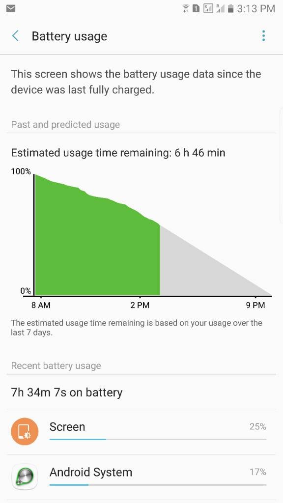

Your phone basically is not deep sleeping, if everything I've told you hasn't worked, then if a Wipe cache Partition doesn't help you must have a rogue app not allowing your phone to sleep, that battery graphic says it all, it's basically drain nonstop at a steady pace and I can guess that you are using it a lot, hence you still manage to get 4 hours of SOT, but if I'm right your standby should suck, so if you don't use this phone constantly your SOT will be a lot worse.
Try the Wipe cache Partition but if it doesn't help consider getting a battery meager app that like GSAM that can give you a more detailed information of nothing helps then a factory reset.

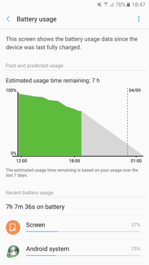

Erasat, it looks like you were right about my phone not deep sleeping. Since the factory reset the battery curve doesn't long like a straight consistent downward line like before! You can actually see when I used my phone more or less throughout the day and you can identify moments of sleep..
I installed only the apps I use this time and it looks like I got rid of a bad app that was suxking my power

I will post my new results at the end of the day but as of now I'm at 4. 5hrs on battery and 1hr sot and 80% battery. Only 5% battery per hour. It's a miracle for me!! Used to be 10+ before the reset.
Let's see how the rest of the day goes.
To be more precise, I'm at 77% after 4hrs57min on battery and 1hr1min sot. Does that sound good? Few phone calls. Social media, forums and web browsing. A 30 minute work out with s health tracking my run....

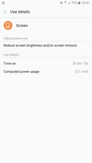

Never really monitored battery life and screen on time before as I'd use my iPhone 6+ in low power mode 24/7. So far on my note I'm down to 70% with 2hrs screen on time. Is that good? Would I really be able to get about 6 1/2 hours screen on with it at that rate?
It's pretty good. It's much better than me at least. I am at the same point as you. 7 hrs and 2 hours sot. Except I have 57% left!

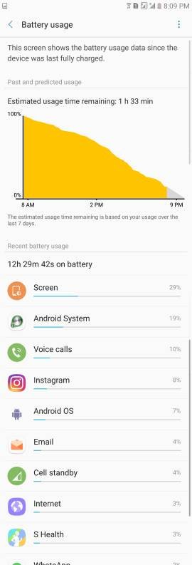

However at the end of the day I don't know if my phone managed to deep sleep in the end... The downward curve might seem less smooth than before my factory reset, but it still seems pretty consistent throughout the day, what do you think?
Yes, seems better than before but still seems like something is draining the battery a little fast. Check my other post where I asked you about the signal strength, besides that there is really not too much to tell you, you got the whole idea now of what may drain your phone, so besides an specific app and the things I've told you and you have done, signal strength is the other possible cause and one of the worst if it's that.

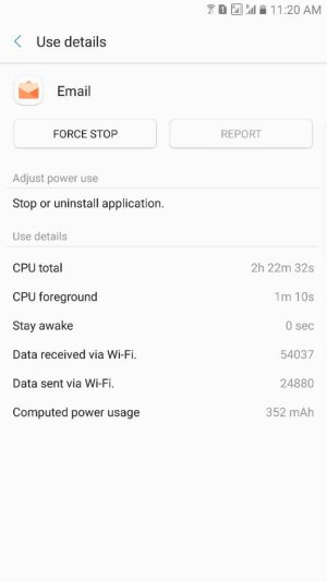

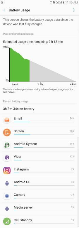

New problem
Today been 4 hours only on battery and already at 60%
The email app is in first place in the battery consuming list. Even before the screen!! The problem is.... I haven't even opened the app and look all the power it sucked me!!! Whyyyyyyyyy
What are you using the email app for, what are the sync settings?
I have it in automatic push, so the email comes to me as soon as it's received. But I've had it like this forever and it's the first time the email app decides to such 15% of my battery on its own...
