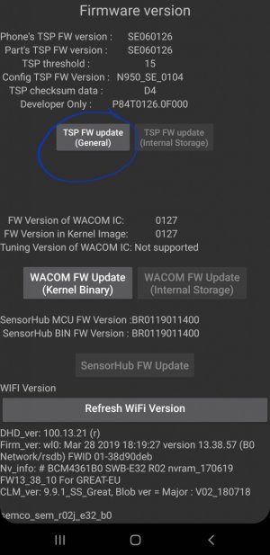

I had the same problem when I replaced the touchscreen on my Note 8.
The solution is to Update the TSP Firmware.
To do that, dial *#2663# on your dialpad and then click "TSP FW Update".
After update the problem will be fixed.
Hope it helps.
