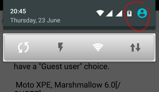

Uh, when I do the pull down menu I don't have a "Guest user" choice.
Moto XPE, Marshmallow 6.0
There should be an avatar top right when you swipe down from the status bar. Another way to access this option is through settings -users.
If you don't get that avatar maybe you'll need to set up your profile in the Contacts app.
