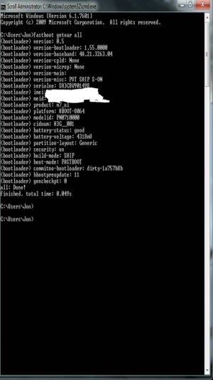

Does it make a difference if I'm using twrp 2.7.0.0?
HTC One M7
CM11 latest
UK Three Network
Still no s-off :-(

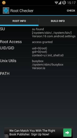

Just tried using revone and all goes well up to the point where I type su, my device doesn't ask for superuser permission. Could this be my problem?
Revone is only supports up to hboot 1.44 I think. Download root checker from the play store and see if superuser is working properly. That might be why firewater/rumrunner is not working.

Still no s-off :-(
