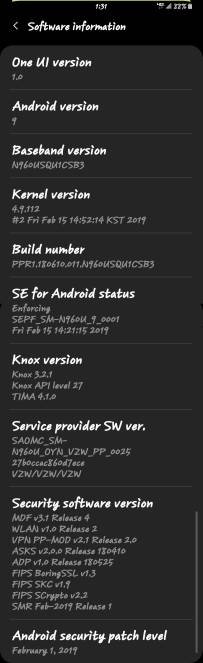

So this is what I'm on now.. will I be able to take the Verizon update when it comes out? Sorry if you have covered this already

Best I can tell so far, the only things you will miss out on by jumping straight to CSB3 is an issue with the compass and maybe a Bluetooth problem.
You should bypass CSAA and go right to CSB3. In basic terms, CSB3 is CSAA with a few fixes and February's security patch.
