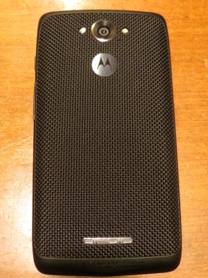

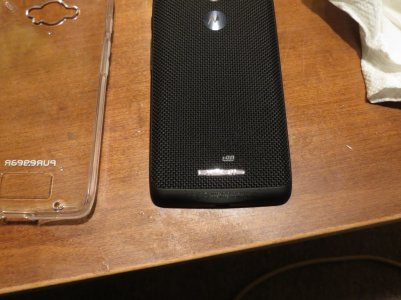

So. Apparently persistence has paid off for me, yet again!
Grab a paper towel, add a little rubbing alcohol, hold said paper towel against the VZW logo sticker for a few seconds, then lightly pick at the sticker with a fingernail (being mindful of not destroying the nylon) and wa-lah! No longer am I a walking, unpaid VZW advertisment! :cool:
Looking at these before and after shots, I cannot express how much more pleased I am.
My clear PureGear case now showcases the ballistic nylon without the VZW logo looking completely out of place!

Yeah, nothing but a sticker. The rubbing alcohol easily absorbed the adhesive though, making removal flawless. No damage to the nylon whatsoever.
Being able to remove this is the icing on the cake for me. :D

So. Apparently persistence has paid of for me, yet again!
This worked as KA1OTE describes, but one word of caution:
After removing the sticker do not put your phone back into the case. Let the back of the case air dry for 5-10 min otherwise it may damage your case. I put my phone on a wood table (screen up) after removing the sticker. The fumes started to turn the finish on the table a hazy white color. If I would have put it back in the clear case I'm sure it would have done the same to the clear case.

I put my Turbo back in its case when I was done so I could take the comparison pictures. I didn't give extra time specifically for air drying, though it makes sense. I checked my case this morning and I don't have any discoloration. So I'm thinking that either it had enough time to dry out during my pictures or the PureGear case has enough ventilation to have not allowed any remaining fumes to build up. Either way, common sense leads me to believe that your suggestion of waiting would behoove those who try this. Thanks for chiming in and I'm glad my method helped at least one other person! I just knew I couldn't be the only one who wanted that logo to be gone! :)
But you have no problem being an unpaid Puregear advertiser?:)
When I bought the PureGear case, I knew what I was getting given the pictures. So, no. No problem with that though the comments are leading me to wonder how I might remove it. The wheels are turning on that project.. and if I do mess it up, it's only $12 for a replacement. Thinking this might be a good weekend project. I'll report back if/when I attempt this. :)
