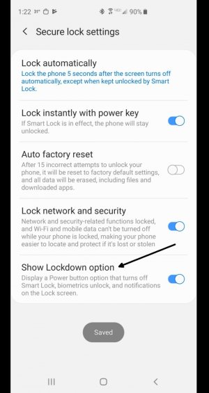

Thanks, that does it! Double tapping will reveal the fingerprint reader, but the PIN pad will open if I swipe up instead of using the fingerprint (or face) option. BTW, I can't figure out what the Show Lockdown (screenshot) option is supposed to do. How do I find the "power button option" in that that's mentioned?
