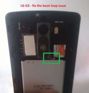

@Vireshen Bhim: that's what I thought too! It's not broken just bent, though. You could try this too.
More details: http://forums.androidcentral.com/lg...oot-loop-how-can-i-get-out-2.html#post5173658
@the core
Soldering the battery is the way forward. I bought a new battery and decided to solder the old one before I tried the new one. After I soldered the old battery and tried and it is working even now and it has been over 2 weeks since I done it and not one single restart on my over 1 year old battery.
I did try the card between the battery trick it stayed on but it would turn off and wouldn't restart again until I plugged it back into the charger
So if you can solder I recommend that you do so,performance wasn't affected but battery will look more rugged as the plastic top bit won't fit back in. But will save you money in the end. Kudos to "the core" and "marko peltonen"
