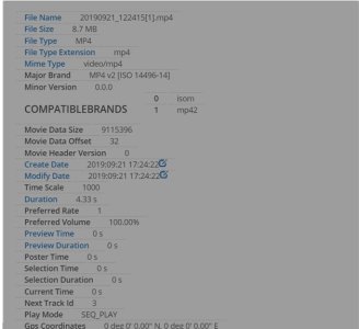

I loaded my Mp4 video files into getmymetadata [dot] com and there is a 5 hour difference between the details date and the create date in the metadata. Anyone know why? The photos don't have this difference.

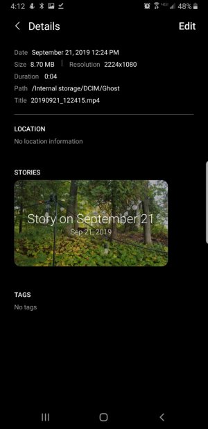

Yes, I have recorded the video with the built in app. The create date is consistently 5 hours ahead in all video I reviewed on Sept 21. It is also 5 hours ahead on one video (didn't review all) on Sept 20 and another video dated months before. This leads me to presume the create date is wrong because there is an issue with Android or getmymetadata [dot] com.

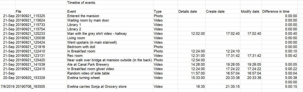

So, after uploading at getmetadata.com, I noticed a difference between the create date and the details date, but this discrepancy is found in all the videos on my Note 8. I was really hoping I was hacked and hoaxed, but it doesn't look that way. Here is a timeline of events with create dates and detail dates.

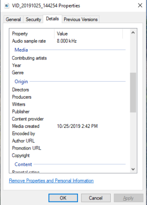

On a PC, using Windows File Explorer, right-click the file, click Properties, then look at the Details tab for the "Media Created on" field. (Be aware that the General tab shows a different creation date/time -- the creation of the particular file, which means if you copied or downloaded the file to your computer, the creation date/time is when you did that.)

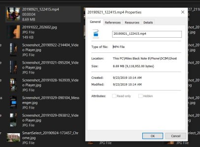

Here is what is on the generals tab:

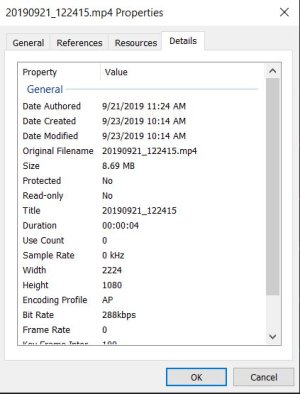

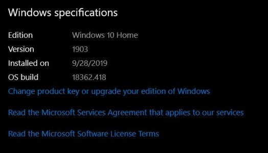

What version of Windows are you on? I'm on Windows 10 -- the Details on mine look a little different:
On yours, the "Date Authored" looks like the closest, but that's still an hour off. I wonder if the change from Daylight Savings Time to standard time might be part of that?

Here is the version of windows I am using:
Question for you. If I move the file from camera folder to a specific folder, does that appear as modified date or no date is given for this particular action?
Good question, I'm not sure. I'm pretty sure that if you copy the file, or move it from phone to PC, the file creation date will be the date of the file operation (but that metadata of when the media was created should be unchanged). I'm not sure what happens when you move a file within the phone's own storage.

Any idea why the getmymetadata.com was showing a 5 hour difference between create date and author date/details date? Could we say getmymetadata.com isn't reliable and the windows file manager is reliable?
A-ha! I think I figured it out -- the site is reporting the time in UTC (Universal Time Coordinated). The site you're using is get-metadata.com, right? (Not getmymetadata.) When I uploaded my video file, I also got a time differential -- but it's the same as the difference between UTC and Pacific Standard Time (my time zone) -- 8 hours. What time zone are you in?

I am central time zone, Moorhead, MN.
