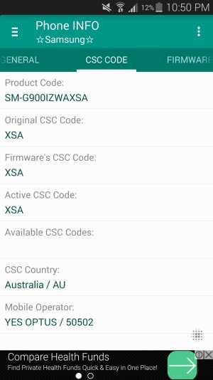

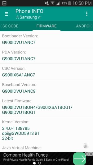

You have the regional model of galaxy S5, the G900i, for Australia Csc code XSA and Product code XSA. The latest firmware for this is...
Model SM-G900I
Model name GALAXY S5
Country Australia
Version Android 5.0
Changelist 5543425
Build date Mon, 31 Aug 2015 03:50:14 +0000
Product code XSA
PDA G900IDVU1BOH4
CSC G900IXSA1BOG1
You are currently on NC7 firmware for Android 4.4.2 which, according to Samsung's records has never been released for this CSC and Product code and could account for missing out on the last 6 updates. For reasons this may occur, see #1.10 of 41 Galaxy S5 models - Dummies Guide
You can either take your phone to the nearest Samsung Service Point and ask them to flash the latest firmware for you or you can download the latest stock Samsung firmware for your model, CSC and Product code, as linked above, and flash it to your phone by carefully following the instructions and video contained in the links of #1.11 of the aforementioned guide.

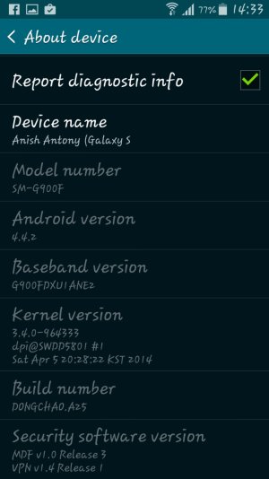

i have a Samsung Galaxy s5 (model number : SM G900F/ Build number : KOT49H.G900FXXU1ALN1) and my current android version is android 4.4.2. i hv checked for new Android lollipop version but my OTA updating is says that " The latest update have already been installed"
i hv tryed both ways OTA and Kies but i don't received any update for lollipop.. i want to upgrade to lollipop and please help me..( my friend's galaxy s5 (SM G900F) has received android lollipop update before a month ago but i don't received yet 😣😣😣)

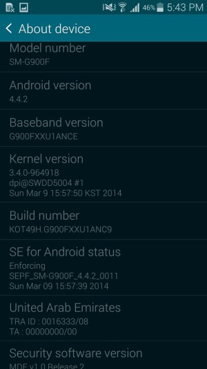

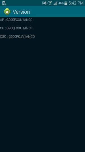

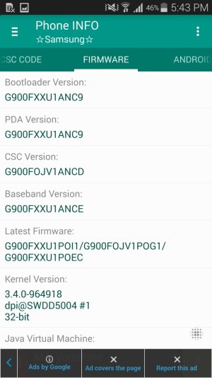

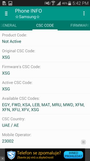

Can anyone help me with the same issue? I just can't update my 4.4.2 android to a newer version. Also I can't connect it to my computer via Kies, Kies can't detect my phone, I have all the drivers...
Thank you in advance. Necessary photos:
View attachment 211354 View attachment 211355
View attachment 211356 View attachment 211357
You have the international model, G900F, for the U.A.E. on CSC code XSG. Since you are not showing a Product code, it could be that your phone has had a different firmware flashed to it as NC9 was never released for your XSG CSC code. You are on the very old NC9, KitKat, Android 4.4.2 firmware.
As for your Kies connection problem, ensure that you are using the original Samsung USB cable that came with the phone and that you are connected directly to your PC and not via a hub. Also. try entering... *#0808# into your dial pad and try different, "USB Settings", (remembering to reboot each time), until you find one that works. See screenshot...
You can update your phone by downloading the firmware below and flashing it to your phone by following the instructions and video contained in the links of #1.11 of 41 Galaxy S5 models - Dummies Guide
