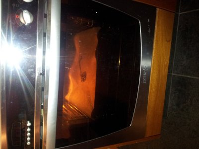

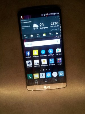

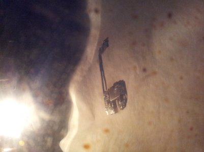

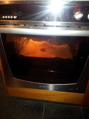

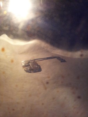

I had the exact same problem with my LG G3, and really thought the baking solution was a joke. But my phone was not working anymore so I had nothing to lose. So I placed the mainboard into the oven at 180°C for 10 minutes, and it worked!! it really worked. For how long I don't know, but I was able to get all my data of the phone and will be using it until it dies again.
My phone started to act up 2 months ago, starting with not being able to read and use the SD card, It had become slow and wasn't working very well, I thought it was just time for a restore. Now after baking the mainboard the SD slot works again, and the phone processing power is back to normal, with much improvement. So I can only guess that the processor was loosing contact with the SD card, and wasn't performing at 100% or dealing with a lot of errors before.
It seems obvious that the processor is loosing contact with the mainboard, and the baking solution seems to restore that, at least temporarily. I would like to get feedback from LG about this defect and a fix for it! It also surprised me that a processor that heats this much does not have a heat sink or thermal paste to transfer the heat into the metal frame, instead of overheating it's own soldering.
