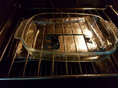

The lowest melting point for solder pastes I found was 361°F (183° C). So I stuck my oven on 365 to be sure it would reflow properly. After 10 minutes, the oven went off and the door came open. I left it in the oven until the pyrex dish it was in was cool enough to pick up by hand. I didn't want to move anything while the solder was still molten.
That was last night and the phone seems as good as new. I'll be adjusting the heat up a little and rebaking if it BSODs again.

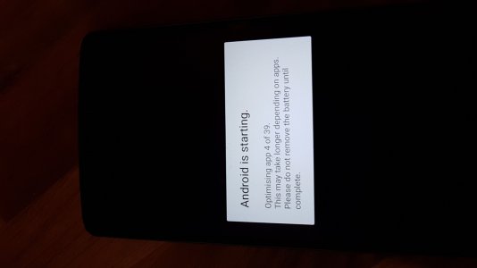

Just signed up to say the oven method worked for me too! I thought it was a joke at first but then saw the photos. Successfully baked motherboard saved the day. Two thumbs up.phone oven.jpgIMG-20180910-WA0007.jpg
Well after 3 months my G3 died again (the day after I accidentally dropped it onto a hard surface - no visible damage). Again I stripped it down to the motherboard and this time baked it in the oven at 200C for 3 mins, (3 months ago I baked it at 180C). Anyway, re-assembled and it now working again.
Update: blue screen appeared after 1 week, so did a bit of research on solder reflow temperatures, baked board in the oven at 230C for 3 mins - working again!
Mine finally blue screened today after 4 years. Cooked the mobo at 325F for 9 minutes, and it's working again. Nice.
