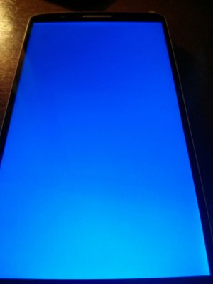

While on Instagram my G3 screen suddenly went blue and proceeded to boot loop. I get to the LG logo and then a blue screen follows, then the phone turns off and reboots to do the same thing over again, refusing to start up
I have tried to re-flash the stock ROM but i'm not able to access download mode as the screen just returns to the blue screen and shuts off.
Does anybody have any experience with this issue?

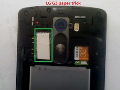

edit: I've got this issue too now. This trick below does not help at all.
It doesn't look like it's related, but you could give this a shot (more info):

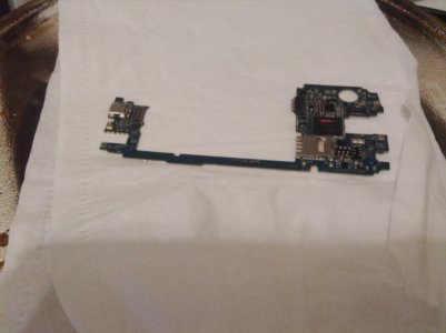

Ha! So, I put the motherboard in in the oven at 180°C (356 F) for 10 minutes and it's working again!
Still, the Oneplus 3 is going to be a nice replacement.
