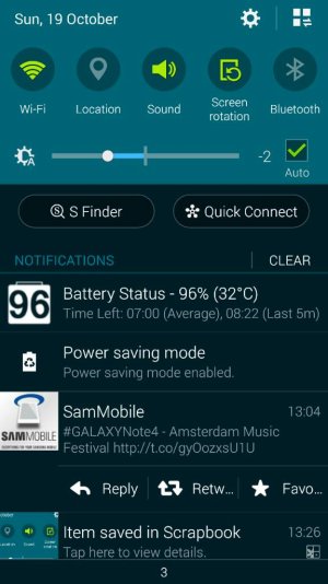

Re: Battery life on Note 4
So far I'm pleased with the battery life. I have been playing with it for most of the day without power saving on. My old phone would drain even when not in use overnight. I'm looking forward to seeing how long she's going to last. BTW, I'm on Sprint. Spotty service at times is not as hard on this battery so far.

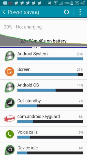

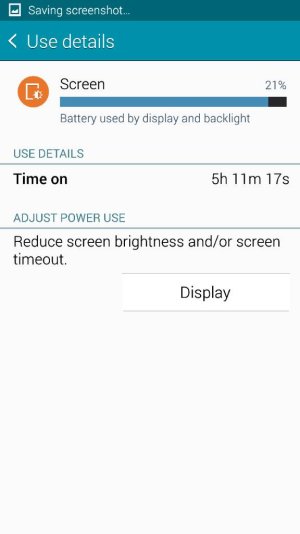

Battery life is amazing for me. Loads better than Note 3

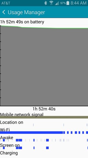

Has anyone else that's experiencing their battery draining quickly on the Note 4 noticed the WiFi arrows are active almost all the time? I feel that this is what's causing my battery life to drain too quickly. There are countless old forum threads from around 2012 that have this issue and it seems to be what I'm experiencing with the Note 4 on AT&T right now. I've tried almost every single fix I could find mentioned about this on various older forum threads with no success up to this point. I haven't had a chance to test if the battery life improves while not on WiFi yet.

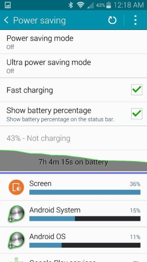

I have a question in regards to the battery. Do you guys who have about about 15 hrs of use and 20 or more percent left on it, have the screen brightness in full? I ask this question because I like to have my screen brightness to max. Also, do you guys have location on? I have it on but the mode is on Power Saving (uses wifi and mobile network to estimate your location). Will appreciate your feedback.
Here's mine and no never have location on unless I'm using maps
Here's mine. I always have wifi, Bluetooth, and location (high accuracy) on all the time. I take the set it and forget approach, just don't want to toggle stuff on and off all the time. I set my brightness at 50% on auto and it works fine for me. With auto turned on the brightness ramps up fine for outdoors. As you can see in the screenshot location is only turning on periodically, it does not stay on all the time. I need it for my commute times in Google Now, traffic around Atlanta is horrible. I'm usually off charger for 15 to 16 hours with no issues. :)
