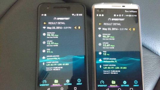

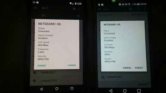

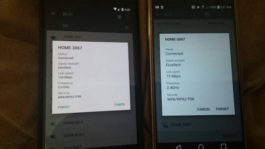

MY girlfriend's V10 is the AT&T variant and on my Comcast router is downloading at about 50 to 53 Mb/sec, just like my VZW V10. However, my Nexus 6P downloads at about 90+ Mb/sec on the same router.
Examples below. Just trying to figure out why the Nexus 6P wifi downloads are almost twice as fast, every time.

I do notice on Aredubu's pics that the V10 link speed is 72Mbps while the 6P is 144. My V10 will not go higher than 72 as well.

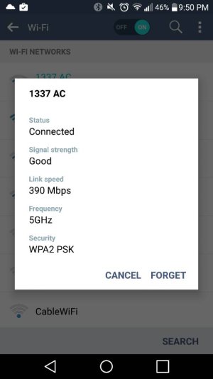

Has to be a bug with router. My link speed is 390mbps

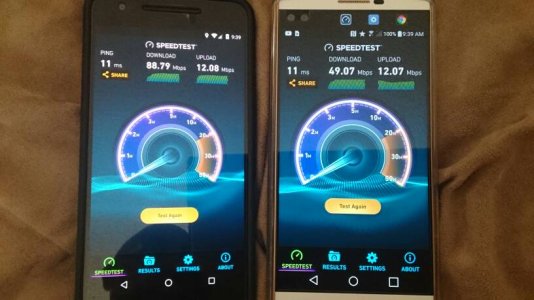

Much better router made a difference. Still, the wifi antenna seems to be different between the 2 devices.
