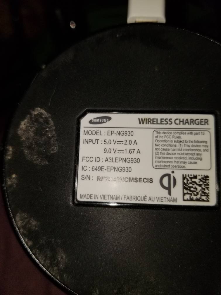

The Samsung one I've got is very much like the one shown by emscapt47 above, but mine is Model: EP-PG950. The current and voltage specs are the same as what his shows.
