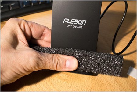

I received the Pleson chargers from Amazon yesterday, and they work if the phone is placed in landscape orientation and held up from where it would naturally sit. I cannot make them work at all with the phone in portrait orientation, just like with the Samsung convertibles.
The center of the phone must be placed close to the center of the charger.
To make that placement easy, I've stuck some cut pieces of rather firm closed-cell packing foam onto the chargers with double-sided adhesive tape so that the phones can sit on the chargers, in landscape orientation, and have their centers lined up with the centers of the chargers.
This seems to work every time, and very reliably so far.
The phone claims to be charging in the fast-charge mode, and does, indeed charge rather quickly, even when running the phone, watching TV on it, etc. Of course, things get a bit warm, but nothing seems "too hot". This is very convenient.

Here's how this all looks:

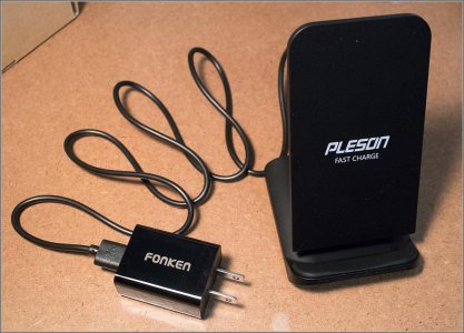

Charger and power supply hooked up.

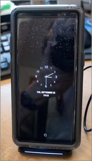

Phone standing up on charger - Note that it is NOT charging.

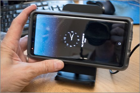

Holding the phone in the one position where it charges.

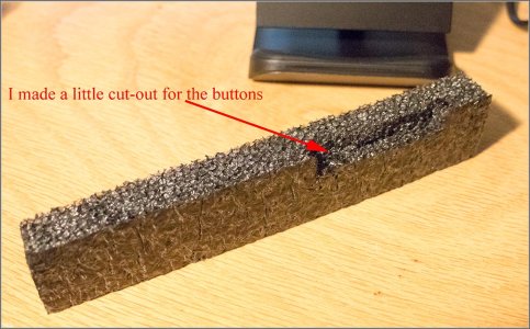

Semi-rigid foam cut to size with cut-out for buttons.

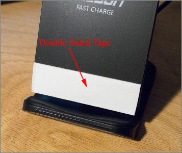

Double sided foam mounting tape attached to charger.
Pressing the foam spacer into place on the foam mounting tape.

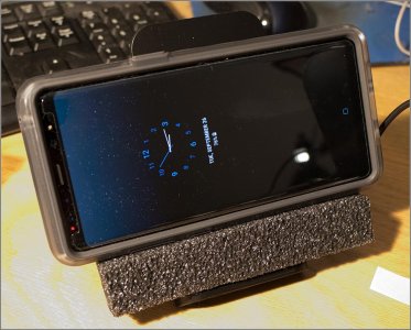

Phone resting on the modified charger, charging happily!
