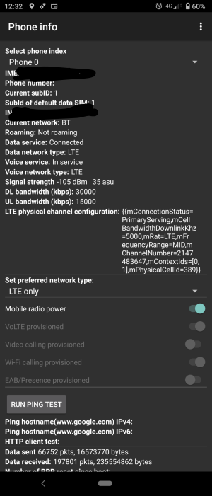

I've attached images of the *#*#4636#*#* phone info page and some other screeshots

Also in your Phone info screenshot the Mobile radio power is toggled off, that needs to be on.
If that is turning itself off you might have a system software issue.

I changed the signal cables because in the *#*#4636#*#* Menu, The Mobile radio power you mention was toggled off whenever it had no signal and refused to be toggled back on. Unfortunately changing these cables the symptoms persisted.
I have attached another screenshot of that menu while the phone is currently working.
I manually changed the preferred network type to LTE only to see if that helps but no joy.
