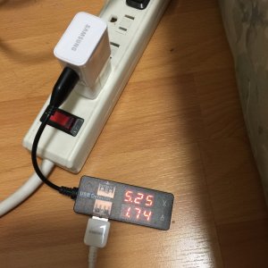

You should use this tool to verify the working status of charger and USB cable.With more than 500 tablets, you should have at least 5 to 10 this USB testers and buy from US sellers for faster shipping.
USB Charger Doctor Voltage Current Meter Mobile Battery Tester Power Detector HK | eBay
https://rover.ebay.com/rover/1/711-...36?hash=item35d679e52c%3Ag%3AZQsAAMXQCZ1TczS3
Original charger should be at 5 Volts, 2 Amps output which you can see on the side of any charger.
When charging, you should have a reading of at least 5 Volts, 1.5 Amps
When using OEM charger, the message : "The connected charger will take longer to charge ", most likely you're using 1 Amp USB charging cable or the under 2 Amp cable, or bad USB cable, or bad USB charging port.
I bought a third party USB cable , it draws only 1.2 Amps instead of 1.7 Amps, Samsung tablet will pop up this message which will confuse a lot of people and make them think the charger is bad. Either wrong charger or cable, you will see the same message. 'The connected charger will take longer to charge. To charge faster, use the original charger and cable that were provided with this tablet.'
