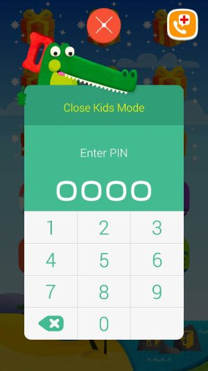

One of the problems we've had since switching is how easy is to dial 911 from the lock screen. Case in point, so far our 3 year old has called more than 5 times by accident just by pressing what he sees on the screen, not knowing what he's doing.
Called AT&T and they're saying they can't block 911 by law, which I understand. What concerns me is how EASY Samsung has made it for anyone to dial 911 via the ICE Address book. It's a special contact that is hidden in the Address Book and shows only there. I reached out to Samsung Support via twitter, and their response was not too promising. I've attached a screenshot of a proposed idea, but shot down. I wish they could take this more seriously.
Calling 911 is no joke and while hiding the phone from toddlers is an option, it can happen again.
