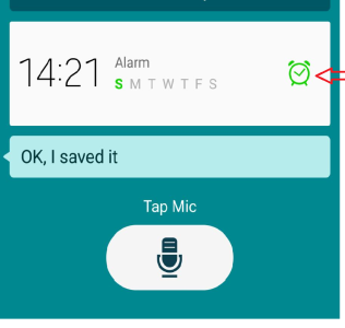

SOLUTION1:try to touch the clock via the white rectangle clock viewsupport samsung.png.
(the clock app will open) and save the alarm from there. works for me in galaxy s5 sm-g900f
