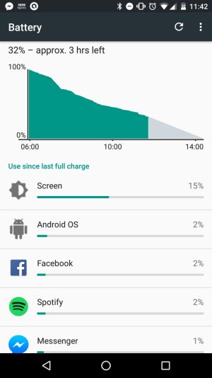

Hi all, I've had my 5X since launch and I just wanted to ask.. does anyone else's handsets battery life really suck?
It started off OK but not great (fine, i can deal with that) but now mine goes from a full charge to under 15% by about 13/14:00 - I use it for music in the car for about 45 minutes in the morning and then leave it alone for the most part as I use my work computer for anything else I need to do.

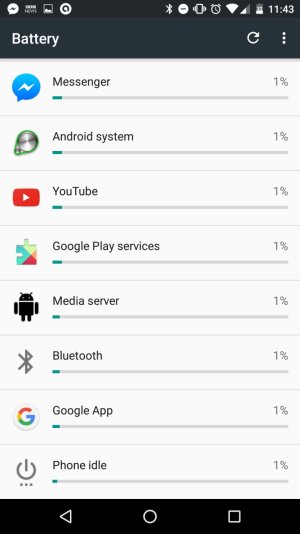

Sometimes, the battery percentage used doesn't add up either - there will be about 20% left on the phone and the battery report thingy only accounts for about 40%.
Any help much appreciated, if this continues I'm just going to contact carphone warehouse.
Cheers,
Jack

Thanks for the help guys, I think I will get this checked out. I've attached a couple of screenshots from a few minutes ago for your delectation.

Before doing a factory reset, just try rebooting the phone and see if that helps. Also recommend GSAM Battery Monitor as a better app for tracking power use.

Cheers for the comments all and - eaccentsac - i've done quite a few power cycles and it hasn't fixed things.
I'll try the suggested battery monitor app - see if it sheds some light on things.
