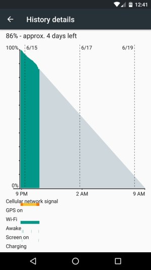

My 5X battery life isn't horrible but it is definitely not what I was expecting. I am an extremely light user and was able to get 3-4 days out of my Moto G 1st gen. The 5X only gets 1-2 days. While I understand the hardware in the 5X is much more power intensive than the Moto G, was thinking I could get 2-3 days at least with the bigger battery and doze.
Am starting to think doze is not turning on. My battery charts look like a straight 45 degree angle going down. My understanding of doze would be that a chart would show the line leveling off a little overnight when it turned on but I still get the same 45 degree looking line. I lose 10% every night without fail.
The phone is primarily in a poor signal area. While my past Moto and Samsung phones were all able to keep about -95 - -105 dBm, my past LG phones including this Nexus 5X get -105 - -120 dBm. I thought maybe LG had improved their radios since I last tried the LG Optimus G.
Does poor signal strength keep doze from working properly?

Shouldn't the line level off a little when doze is supposed to be activated overnight?
Or do I have basically no apps coming on overnight and doze has nothing to do? Guess this would make the poor signal strength the culprit.

Do you see the line that says "Awake" with some little green bars below it? That shows that your phone actually is asleep for most of the time.
[edit]: And of course, to operate as a _phone_ the cellular radio has to be on all the time. I would certainly expect the [yellow] signal being shown to affect your battery.

I can leave mine all night and lose around 3 percent, and yes the line is leveled off. Something is eating your battery and it could be that yellow and orange cell signal

You realize you're looking at an estimation stretched out over a projected four days of use, right? With your phone sleeping as much as it does, you're not going to see leveling off because there's nothing to level off from. It's going to hit zero eventually, and the steady drop will look exactly as it looks on your screen. If you look at just a day's use - the dark green, for example - you'll see that your phone used 14% battery. If you stretch that day across the whole graph, your line would change from a 45 degree angle to something more like a 20 degree angle. But it would still show no leveling off, because it's already showing minimal activity.
I think your battery is fine.

I understand the difference between the green and grey. Probably should have shown a pic from when it was closer to 0 than right after a charge.
What it really came down to was I thought 10-12% loss overnight was really too much when the phone was doing nothing.
Guess I should really be upset at the poor signal strength of LG antennas. Was able to keep much better strength with my previous Samsung and Moto phones compared to the LG phones I have had. I'm remembering now why I stopped buying LG but the Fi 5X deal was too good to pass up.

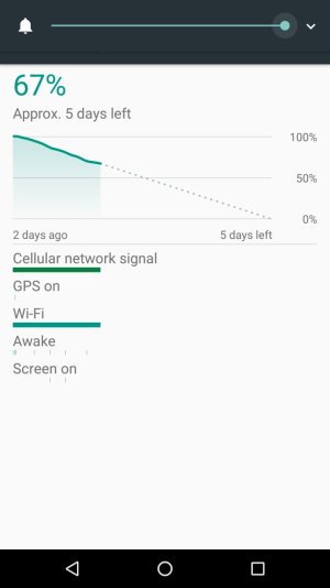

I'm guessing you are looking for something more like this:
Granted, my 5X has extremely light use, SOT is about 15 minutes. As others have stated, I'm guessing much of your issue is related to the poor signal. But even with the light use, you can at least see the curves in the graph from when I've used the phone

Yes that is what I was expecting. My use mirrors yours with SOT. Your graph has an estimated 5 days left even at 67%. I can't even get a 5 day estimate right after a charge. The key difference appears to be the strong signal vs my pretty poor one. If I used the phone more it would probably be more of an issue but it really isn't that big a deal. Was just envisioning something more like of your graph.
