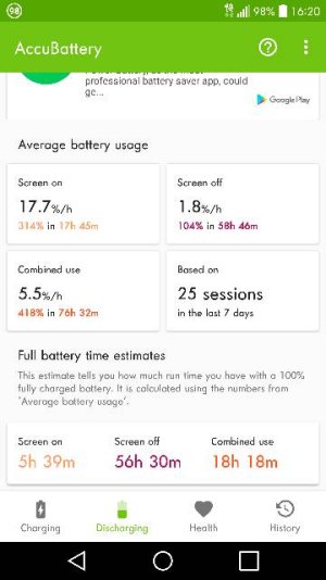

crisis averted. i uninstalled the facebook app and my battery has only dropped 3% in 2 hours. i'm not surprised that it was facebook, but when i checked app usage it only showed at about 4%. so i do have questions about what facebook did to my phone...

when i was in safe mode i remembered that facebook had automatically updated 2 days before so i rebooted and disabled it for a few hours while i charged. it took about 40 minutes to gain 85% on a 3rd party cable so i uninstalled it completely and now i'm fully functioning.

I'm glad you had no issues with your S7E but you can't compare it to my V20. Different specs, different battery, different hardware, etc. My V20 runs great without FB installed & I'm getting 6 hrs SOT now so it's one hell of a band-aid.
