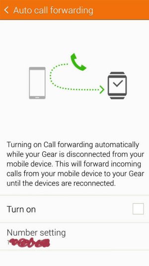

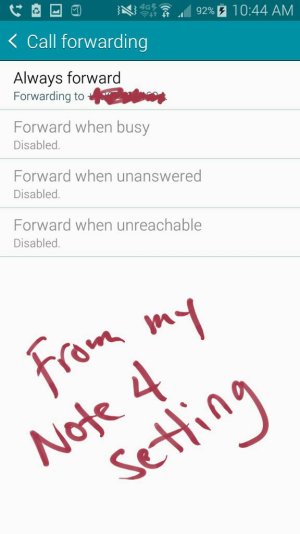

Perhaps someone can confirm this. I have TMobile and Note 4, but all I need to do to enable call forwarding is to enable it in Call Setting on my Note 4, no need to do anything else, not even to check the box in Gear Manager or even on my Gear. I only use call forwarding when I have my phone in my car, gym, home, or office. When my phone is with me, call forwarding is off since I rather take my calls on my phone.

That's what I do since I don't use a Samsung phone. But the Gear Setting just automatically do it for you depending on the situation. They all came down the same call forwarding code to the carrier.
