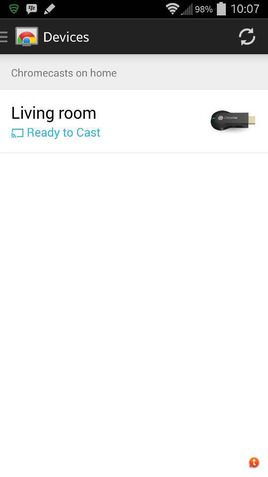

You guys seem to misunderstand what the Chromecast app is for. It is solely used to manage the Chromecast - primarily to setup the WiFi connection but can also be used to reboot and factory reset. It is not used to cast anything ever and does not even need to be installed on your phone at all if your chromecast has already been setup to connect to your wifi network. When you click Ready to Cast in the Chromecast app it is supposed to go to settings because that is its only purpose.

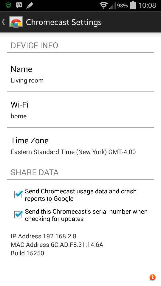

Don't know if it helps Scott, but here are a couple of screen shots for you.
Just for giggles can you also screenshot your phone Wi-Fi info. Just IP and wifi connected.

That's odd, If I turn wifi off, I lose the CC icon on netflix, it works just fine if I turn off mobile data, in your screen shot I noticed the 4G icon, If your phone is not exclusivity using Wifi, it will not give you the cast option. This has to be a setting problem somewhere causing your problem, one of those little things that make you do a face plant when you figure it out
