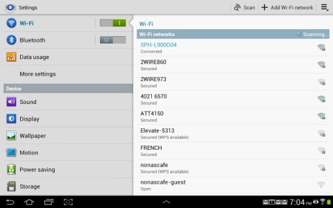

I don't understand why it's not working for you? I also own the Galaxy Note 2, and use it as a hotspot to connect my Note 10.1 at work since we don't have wifi in my building.
See first device listed. It's the Note 10.1 connected to my phone as I type this email. It must be a setting somewhere since I know it works.
Sent from my GT-N8013 using Android Central Forums
