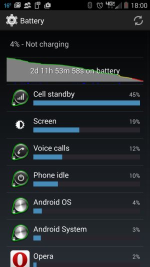

Just checked my wife's DT and it seems your cell standby is way higher than her 2%. Also, you are showing only 3g and not the 4g showing on my wife's phone. Is the signal very poor in your area?

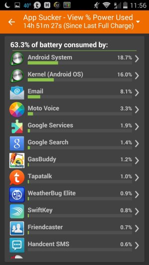

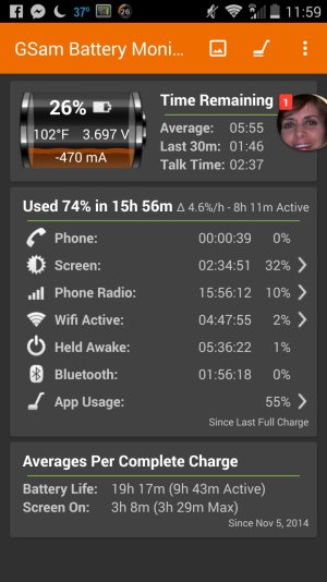

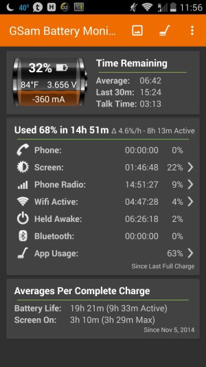

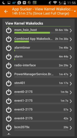

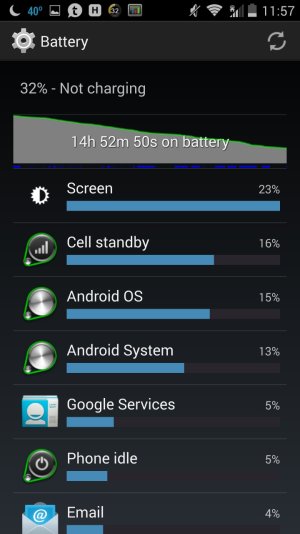

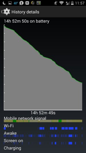

Ok, Friends. I'm sickly jealous of the numbers I'm seeing on this thread and am dying to get close. I come to you with screenshots in hand and am begging the advice of those getting nirvana on this battery. ;-)
I have done everything advised on this thread (save for the most extreme measures, which I'm hold until last resort). These numbers are admittedly not "bad", but I know I should be able to get what most of you do - and don't feel that these match up.
I have turned off the IR sensors as well as most of the Moto bells and whistles. I have Automate-It turning off 4G data whenever I'm on Wifi, and today I set Location to Battery Saving. I'm at a loss why my number aren't through the roof, given all I've given up.
Two points-of-note .. I have the phone checking ONE pop3 email account every 30 minutes. Why would Email be using up so much battery? Another - my wakelocks are huge, but I have no idea why.
Thanks for the info, Jay! Actually, I'm not even sure what "cell standby" means here... will have to research that a bit further but it seems close to some other screen shots in this thread. BUT, does the phone use more battery when in 3G instead of 4G? If so, that may explain it because for about 23 of the 25 hours I posted above my phone was in 3G... about 13 hours in an actual 3G data connection and then 10 hours in the 3G connection while connected to my extender. The phone has an extra little symbol on it when connected in this mode but not sure if, battery wise, it would be the same as regular cell tower 3G but I think it is.
During that long stretch of the WiFi being on, the phone was at home sitting on the counter not being used. And that large green section for Mobile Signal is when my phone was connected to a Verizon Extender because I have such poor reception in my house I bought one of those.
What is interesting though is except for that time when I was using my phone nearly constantly and I had the steep battery drop, the time were I was occasionally using it but still using it has about the same slope as when it was just sitting on my counter not being used the last 10 hours of the graph.
Seeing what hannsoft just posted, I'm not interested in saving battery THAT much. LOL I got my phone to use it and use its features. I charge it every night so being able to go 2 days without a charge isn't a huge concern. I'll also add that since I took it down to 2% in order to make this post with the pics and then recharged it, it seems like the battery is staying up much better but that could just be my imagination... will have to test during a "normal" work day when I don't drain it down so far.
Thanks!

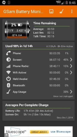

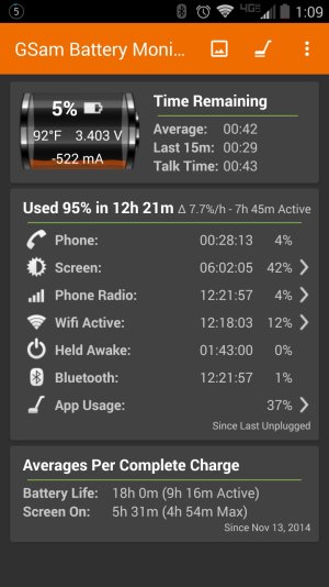

I'm officially part of the 6 hour club. :)
Sent from my Motorola Droid Turbo

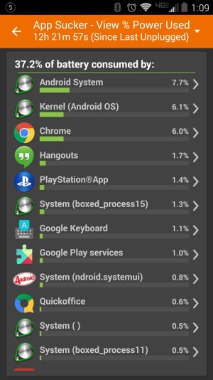

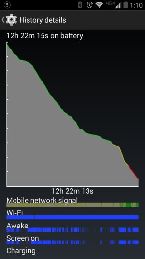

Ok, so in my frustration last night I thought "ok either no one has any clue about the peculiarity of my numbers or I'm some kind of periha and no one wants to help" . ;-)
So I turned on almost every option I had turned off and said f-it, I'm just gonna enjoy the phone and it's awesome featureset and get whatever I can out of the battery. After I did that, though, I started looking closely at some of the apps running on the phone and noticed that some of them had been running in the background for 150+ hours. Damn, I thought - been a long time since I rebooted! Those apps aren't showing up as battery hogs, but wow - running that long, they have to be using up something, and I'm not using them. So I rebooted.
What a difference a reboot can make. Look at today's numbers. MUCH better. This thing has been sipping at power all day, and really only started going down at a decent rate tonight when I've been using the heck out of it. Texting, Facebook Messenger, a YouTube video, etc. Lots of screen time. Still not the 4+ hours that many of you get, but I think now the that I'm barking up the wrong tree. I've used the phone like crazy tonight and, after almost 16 hours I still have more than a quarter of my battery left. Damn that's good. I can be happy with that.
So here's some battery advice. Like they say at Dell tech support: when in doubt, reboot. No, just try it. Really. Can't hurt, but it sure can help!

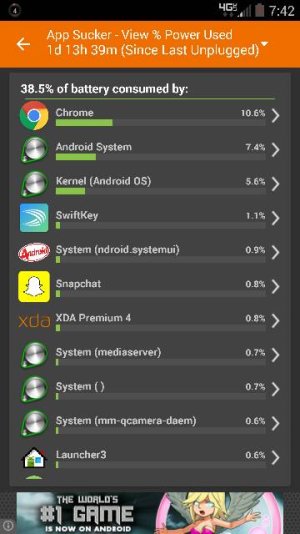

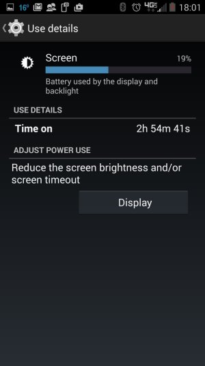

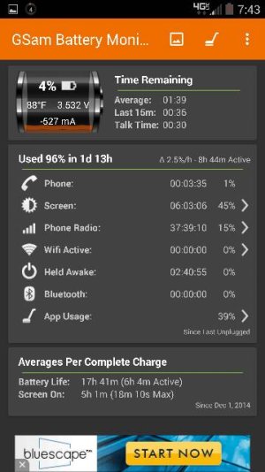

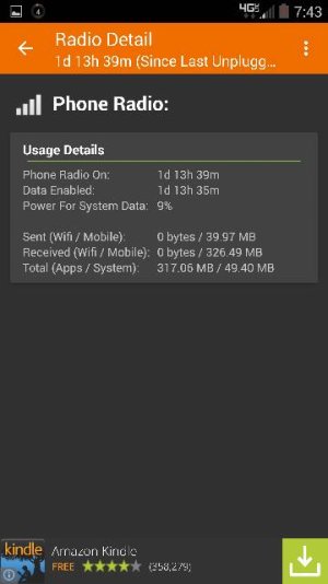

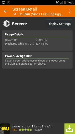

Here's my last run.
Well guys here's my last run, it doesn't get much better then this. Over 6hrs of screen time, I ended up getting 39hrs off the charger before it completely died, this was with no WiFi also, all 4G data. I think with a solid 1 day of heavy usage I woulda got over 8hrs of screen time with no problem.
I'm really happy with these stats. My brightness was set to around 1/3 and I had no GPS location services on, moto display is enabled and surprisingly only made up for .4% of battery use.
Guys this phone can show good battery results u just have to strive to make it your #1 thing when u use ur phone. If u stay on top of it like I did you will get similar #s.
Note: the last pic was my final screenshots and then the turbo died.
Edit: also if u think about it, 39hrs is getting close to the 48hr mark and 6hrs of screen time is also a decent amount. 48hrs could be easily achievable if I would have had a hour less screen time.
