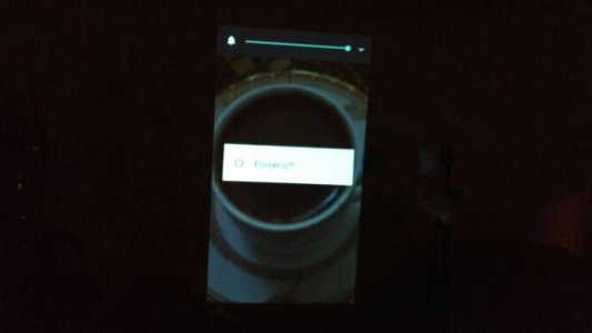

epic fail. these are the only actions shown on the projector. no swiping or touching on the screen would do anything. Also I only managed to get them connect once. I kept trying for another 30 min with no success.
I don't know what else to try.

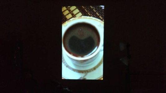

this is the home screen and it's wallpaper. everything else is gone somehow.
