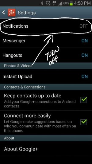

I had the same problem with battery drain, so I turned off notifications in Google +. Just like that I was back to very good battery life.
I left instant upload on because in my case the culprit was the excessive notifications every time somebody posted anything.
