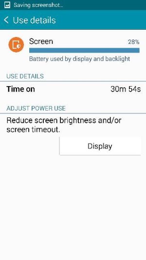

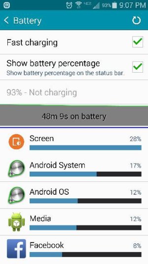

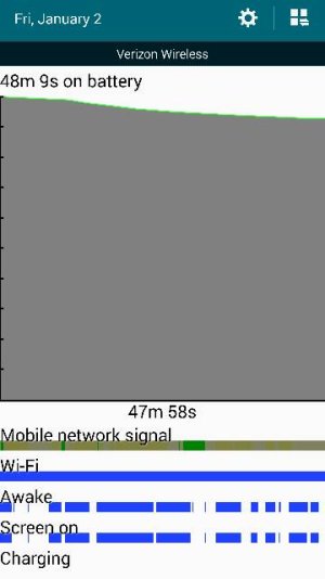

My battery life is bad can someone please help
Yours actually doesn't look that bad. Your screen was on for the majority of the time you measured in that screen capture. That will drain battery. Your CPU goes to sleep when the screen is off, that is a good thing.
What do you have your screen brightness set to? If it is on "auto" you might want to consider turning off auto and backing down the brightness to 5-10% (or, just bright enough to read indoors) for the majority of your use. Switch to auto when you are outdoors for long periods. Adjust brightness manually as you see fit for other situations.
I rarely adjust brightness through most of my daily routine, since I am indoors a majority of the day working. Battery performance is excellent with this method and the rest of my setup.

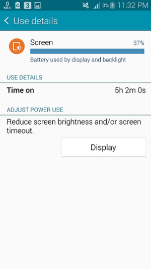

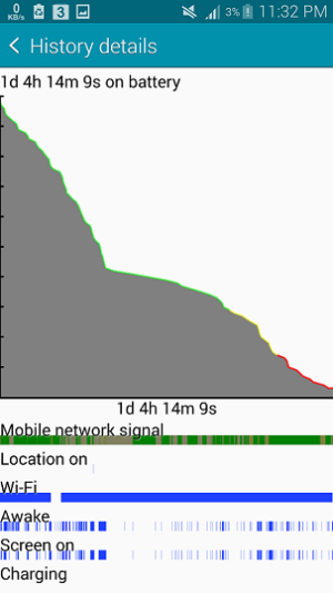

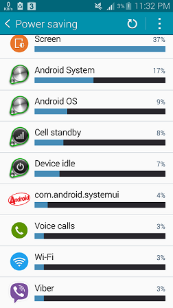

can tell me about battery consumption for my note4 n910h ? good / average or bad ?
my wifi is always on and viber working lots of time !
what you suggestion about it ?
thank you so much
