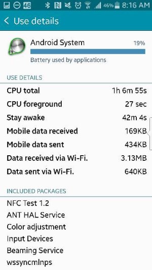

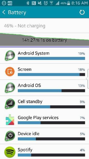

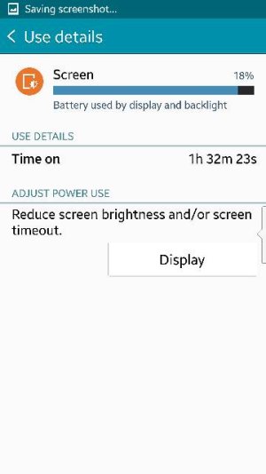

I lost 20% while sleeping... I have two Batteries I switch, so it's something on my phone causing poor battery.
My screen is never at the top.

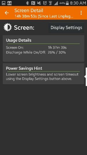

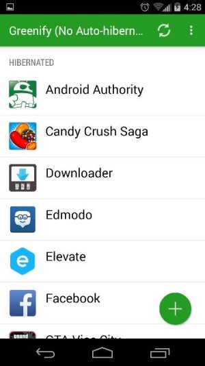

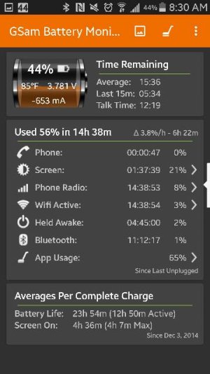

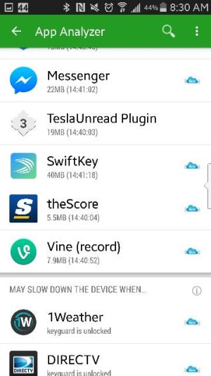

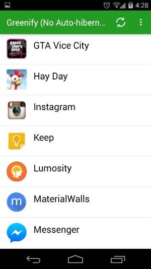

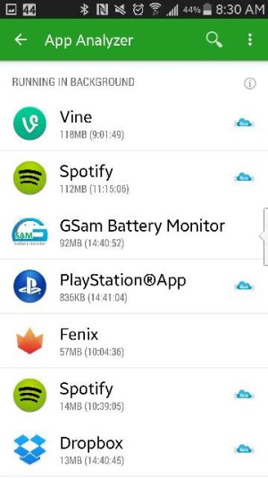

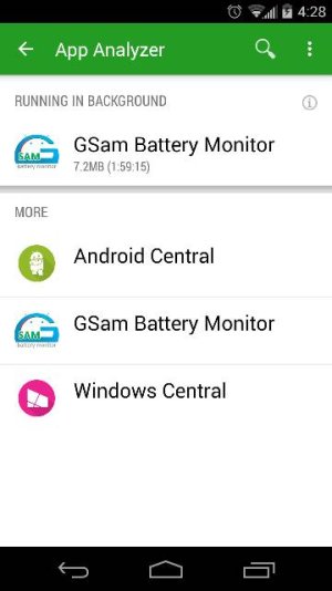

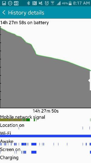

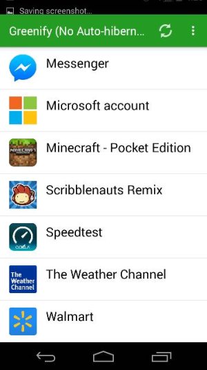

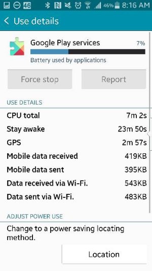

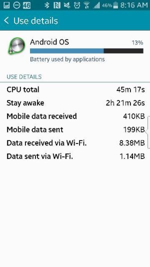

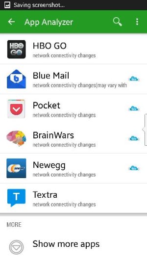

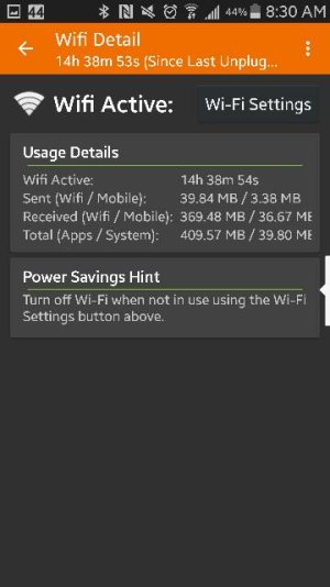

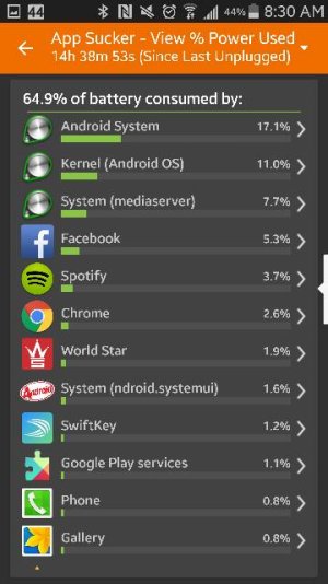

Can anyone help? Maybe my battery is fine? I really have no idea. I don't know what I am even looking at coming from iPhone.
Here are screen shots from GSam and Greenify
Thanks!

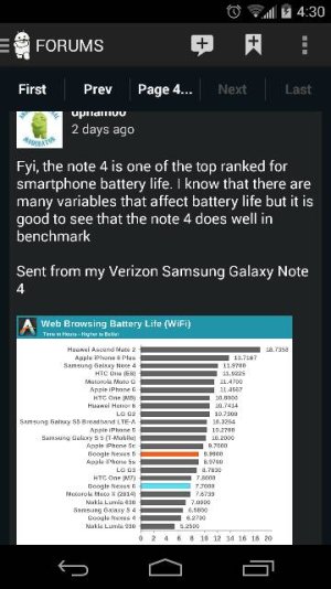

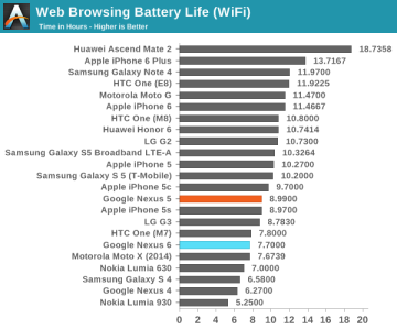

Fyi, the note 4 is one of the top ranked for smartphone battery life. I know that there are many variables that affect battery life but it is good to see that the note 4 does well in benchmark
Sent from my Verizon Samsung Galaxy Note 4

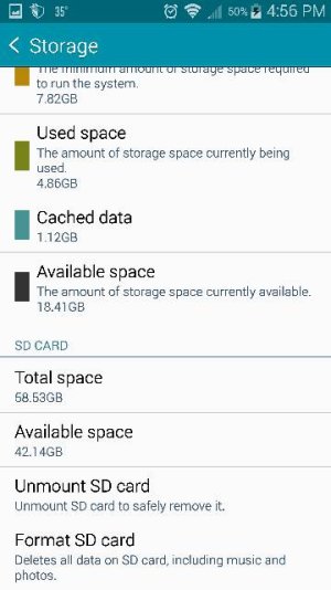

I've been reading through various forums trying to pinpoint the "Index Service" battery drain on my Galaxy Note 4 and this looks like the best place so far. I got my Note 4 and was ending the day with ~80% battery after using it consistently all day. I installed my 32GB SanDisk microSD card that I used in my old Galaxy S II, then I found my battery draining in about 8 hours with Index Service using ~50% of my battery. I thought maybe a new SD would fix it so on Black Friday I bought an even larger 64GB Samsung microSDXC Class 10 UHS-1 Memory Card from Best Buy and transferred my old files to it.
Now my battery life is draining from 100% to 12% in ~4 hours. I did put my old files on that new card but I've been having this issue for over 3 weeks, so Indexing should be finished by now. It has to be a bug. I read somewhere to remove the card and format the SD as FAT32, also remove .pdf files, and any files over 200MB. I haven't tried any of this yet, but I thought I'd post my pics and say that Samsung brand cards DID NOT fix my issue.
I forgot to mention my phone has been running really hot ever since I put any SD card in with my old files. I can feel the heat through my pant leg to where my phone will make that area of my leg sweat. Definitely not good for a battery.

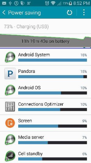

I took my SD card out for the entire day today, also was running pandora non-stop for about 6 hours. It was only at 76% after that. Going to format and try loading individual file types one day at a time to try to pinpoint the issue. Removing SD fixes it for sure though (not really a valid solution)
Ya, I don't understand why so many of us are finding our old SD cards to be an issue or perhaps corrupt files on it..... Since I removed mine, huge difference in my phone.
Running Pandora 6 hours straight and 76% left, Wow! Also, I noticed you are charging by USB. I know others have said that you get a much more solid and faster charge on Wall outlet.
