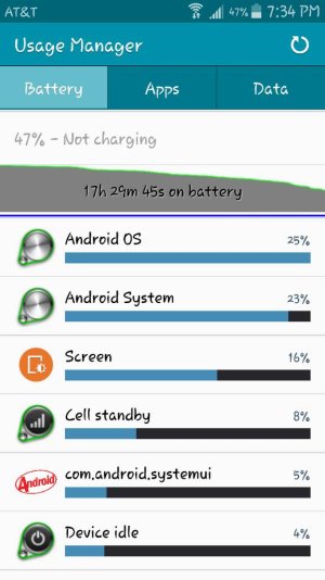

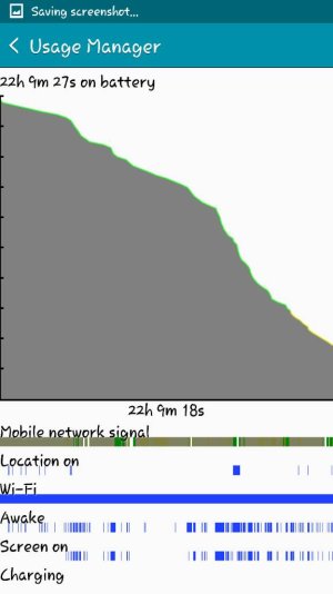

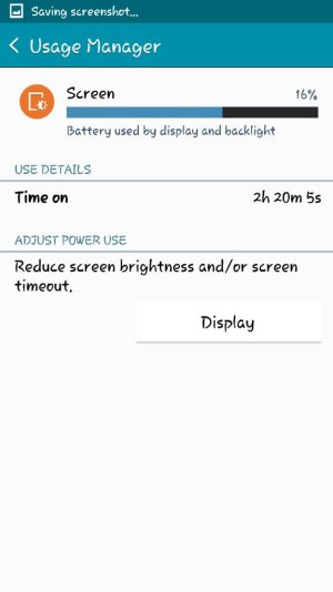

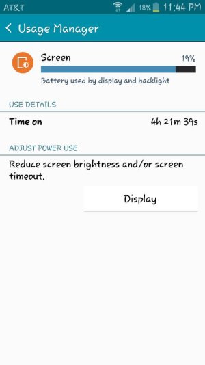

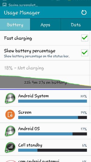

Does this look decent to you guys? My first Note, so I'm not real sure what to expect.

Looks pretty good, start the next reading at 100% and take screen shots when you're close to 15% battery
My wife is getting 6+ hours of SOT with location running all day... But my signal is not the greatest in my office and no wifi, while she is at home (excellent signal and wifi) and very low brightness.
